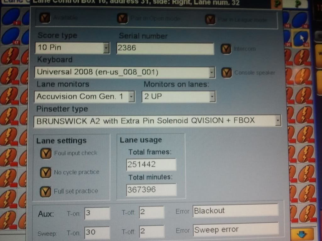

              When you bring up the page it should be right in the middle of the page...closer to the top. Here is an image from my center.
              Let me know if this helps...I think it should.
                I think I know where that is but to get to that screen, if I remember right, everybody else has to be off Conqueror?
                So if I swapped between pairs 1/2 and 3/4 for example, I would go back after they booted up and get to this screen for 1/2 and change the serial, then do 3/4... correct?
                  I found it Steve, on our system all the other nodes have to be logged off to get access to it but that's fine, I know where it is now. Thanks for the help.
                    You disconnect the 3QT's, change the serial numbers in lane setup to non-existing serial numbers, change the 3QT's around and turn them on. Turn on one of them and do the box replacement procedure. It will find a serial number that it does not know and all you need to do is tell the system what pair has that new serial number. You will need to upload programs and then move to the next 3QT.
