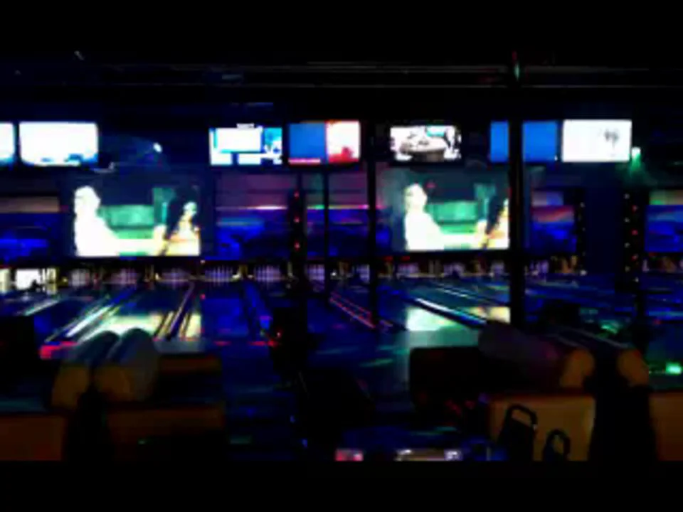

      The new PinCam camera has the ability to score under any lighting conditions, plus it calibrates itself after each ball rolled. Check out this video where the new PinCam was scoring perfectly with this light show.
      This video shows the latest LED light show at a bowling center using Steltronic Scoring and the new "PinCam" camera. The new camera has the ability to…
      The new PinCam highlights here:
