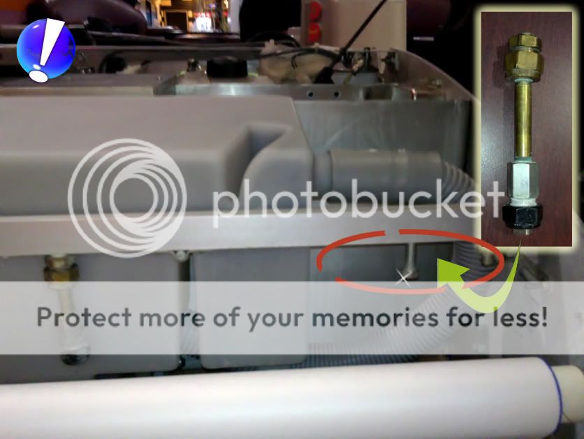

    Found a nice 2 years old A22 machine in very bad condition and sadly discover "master" repaired it wierd... he screw (guess by force) a metric nut in hole coz part was broken After testing cleaner pump not a single drop of cleaner came out spray nozzles are so dirty that it blocks liquid to come out.
    After i checked vacum motor assistent who works with that "master" was like coz he never heard that noise in his 7 months working there Then i checked what pattern they use i was coz there was only oiling and no cleaning on it (see pic) and i found why... OK lets clean nozzles and try to run after changing pattern (there was way to much oil on lanes) Guess what? Machine didn't run coz error on lane sensor Checked that one and found out that that "master" bought a sensor in some store wich didn't go with that machine... And best part: they bought new mother board, coz machine didn't work as it should
    So daddy has to come back some other day to change some things on it and make this thing work propperly
    Advice to all "selfmade Masters": Please, Please don't fix things if you don't no how

        hehe not only leftys... or rightys... any, but ok next week i got some spare parts to make this back as it should be
