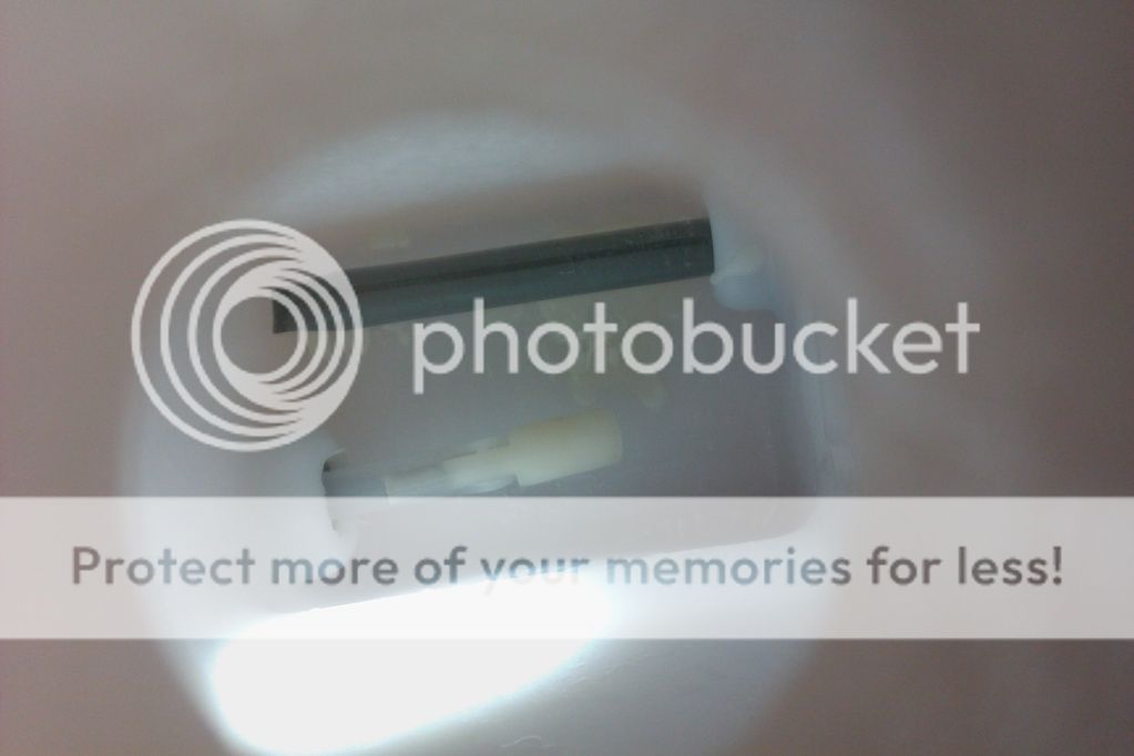

    Got complaints of the shot breaking down quickly. What to do, but calibrate... right? (brand new ION Sport)
    Calibration came out exactly 20ml, but wait.... What's wrong with this picture???
    That is suppose to be Kegel Infinity. Hmmmmmm
    Looks more like.... well, you know
    Ever wonder what might happen if someone put cleaner in your oil tank?????
    Wonder NO MORE!! It turns the oil to HOG SNOT!
    This pic is looking into the conditioner tank AFTER a dump and rinse with lane cleaner. (white slime still on bottom)
    After a few more rinse cycles and a complete drying, the tank was clean again and ready for use.
    A HUGE shoutout/thank you to Kegel Tech support for giving me proper technique for flushing the pump/lines/valve/gauge and not causing any further damage.
    What a waste of 5 hours of my day!!!
    Tanks are now CLEARLY marked.... 'CLEANER ONLY' 'OIL ONLY'
