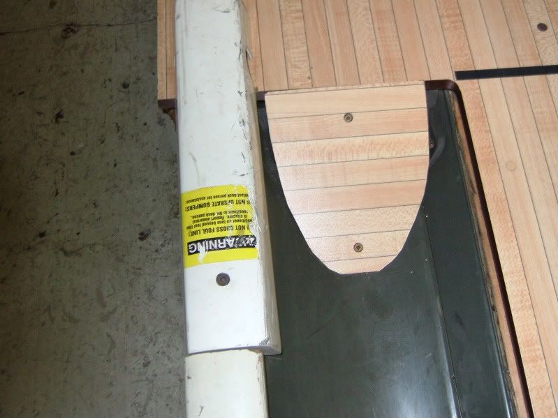

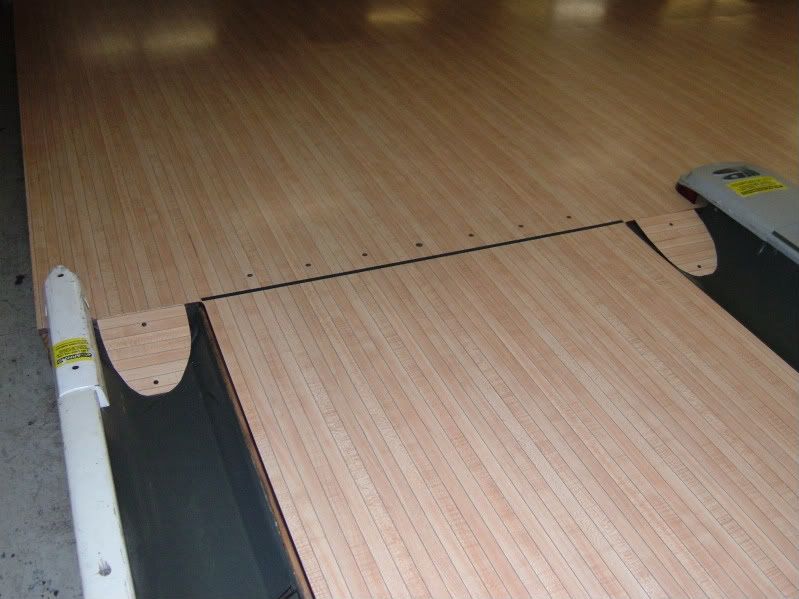

          If it is dripping when you pull it off the lane you might need to adjust your transition blocks on the gutters for a smoother exit
            Thanks for the input guys and (King), I know some of the transition blocks are low do to the different stlye of gutter throughout the center. I saw Pinsetter parts plus makes a transition block kit, I may try one and see how it works. Its supposed to bring the block even with the approach?

                Good job on the newer blocks - makes it much easier to get off the lane
