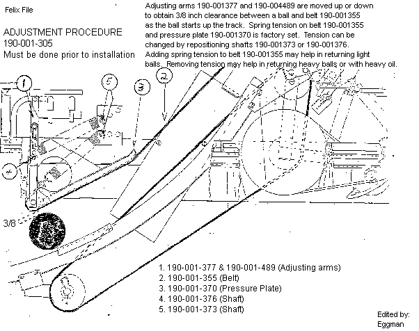

SurPik Diagram

                          Re: SurPik Diagram
                          That's a nice diagram but it notes that the adjustments must be made before installation. Do you have anything else for tips/adjustments etc. Just learning them after moving from Bruns lifts. Also, the safety link doesn't work (I know the post was 7 years old) can you find it elsewhere?

                            i think the safety link was about kids getting hurt by sticking hands in the lift. you should have plunger type micro switch installed inside your motor plug box that kills the motor in the slidding door is opened on sure-piks model 190's saftey switch part number 190-001-307 and flip open lid on model 208's saftey switch part number 759-510-029
                            i don't know if these parts are still available but these were the part numbers in my book.
                            jim k
                            jim k.
                              Re: SurPik Diagram
                              I think the link had pictures showing plastic guards surrounding the exit of the sur-pic, to try and avoid injury. It is a pity is doesn't work...
                              There are other adjustments to the sur-pic, not just moving the shafts and springs about. You can re-position the frame as it is adjustable. The frame screws can be loosened off and the unit repositioned, which helps to get the balls up the lift in times of difficulty. Cleaning the leather strap with a wire brush also can help.
