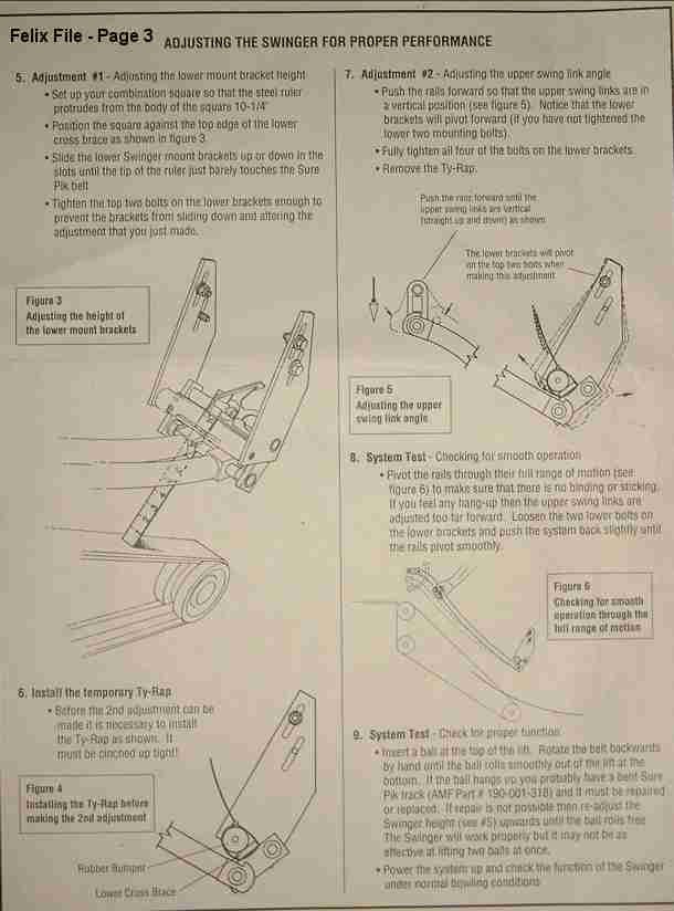

    Thanks Felix old buddy!
    I still have a pair of lanes that will not accept a Swinger.
    It puts too much pressure on the belt even at the highest position.
      Re: Swinger Diagram .jpg files
      My King; Can't imagine not getting the swinger high enough on the entry of the sur pik but I have had to cut the hood guides (208 111 123) at an angle so that the top of the swinger doesn't bottom out on the guides. I also use the brunswick gummed rubber on my rails. [img]/content/btubb/images/%%GRAEMLIN_URL%%/wink.gif[/img]
        Factory sur-picks across the house, Clean them twice a month and only have 5 or 6 under grounds a year. Mostly from bowlers who need a thumb hole 1 1/2 inches across. I like my sur-picks, But then I like my hump-backs too. Must be a mid-west thing !!
