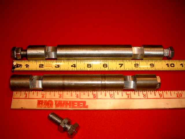

    Tool Or Part ???
    For me it's a part.

      Looks like a ball lift shaft for hex-bore bearings. If only there where such a thing [img]/content/btubb/images/%%GRAEMLIN_URL%%/laugh.gif[/img] or is there?

        It lookings like the shafts from a PBL, but they a really worn. Also yes the PBL shafts can have D-Bore bearings. All of mine have them. I was wondering are these shafts from a kicker? I have never had any experience with them so I am not sure what it looks like.

          well it looks like a rudder shaft and bolt being
          used to be used for other purposes [img]/content/btubb/images/%%GRAEMLIN_URL%%/confused.gif[/img]
          maybe to install or remove bushings [img]/content/btubb/images/%%GRAEMLIN_URL%%/eek.gif[/img]

            My second generation kickback spreader. Wished I could show you the first proto type but its still in a machine.

                <font size="2" face="Verdana, Helvetica, sans-serif">Could you please explain how and why?

                  ED;
                  The Why of it...I had a pair of lanes where as the inside (kickback panels) of the machines were like 8.5inches measurement(inside/width). Balls would actually get stuck(between the 2 machines) trying to go up the up rails. How--- With this jackscrew I can spread the 2 machines to desired width and not worry about it narrowing again. Simply hold and unscrew with wrenches. Make sure you don't go wider than wood kickbacks and replace frame bolts/nuts&amp;washers. [img]/content/btubb/images/%%GRAEMLIN_URL%%/wink.gif[/img]

                    Kewl.....I have had to do that before but I just used 3/8 all thread. Looks like a neat little tool though!
