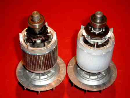

    Anybody have a part number for the new-type WH BE centrifugal mechanism? It's the coil-spring type with a 2" switch plate.

                Thanks but that's just it - it's not in the Vantage catalog. I don't think it's in any catalog. It's a mech that's only been used for a couple years by AO Smith, only in 60hz BE motors (070 100 510).
                It's similar to item 29 on page 38 of the Vantage catalog, but the plate is a much wider diameter. It works with the purple switch, I'm not sure of the part number on that either...

                  [img]/content/btubb/images/%%GRAEMLIN_URL%%/laugh.gif[/img] ??? 785 501 168 [img]/content/btubb/images/%%GRAEMLIN_URL%%/confused.gif[/img]
                    Re: Part # Question
                    Yes! Felix, that's it! The one on the white rotor. That number ain't right though.
                    Funny - we're able to get a picture, but not a #.
