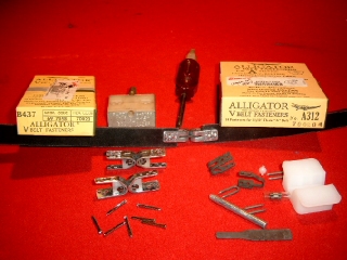

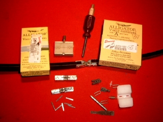

                            These Power Twist Plus V-Belts Look Mighty Promising. [img]/content/btubb/images/%%GRAEMLIN_URL%%/wink.gif[/img]
                              Re: Another Jerry rig
                              Ah Yes, Aligator clips. Many 82-30's have them. Do they still sell them? I wish AMF would have made a spliced belt for the 82-70 from the beginning. I hate having to unbolt the distributor just to get the pinwheel belt on and off. [img]/content/btubb/images/%%GRAEMLIN_URL%%/mad.gif[/img]
                              Louie
                              Experience: Currently Help Maintain 44 82-30s and 50 82-70s.
