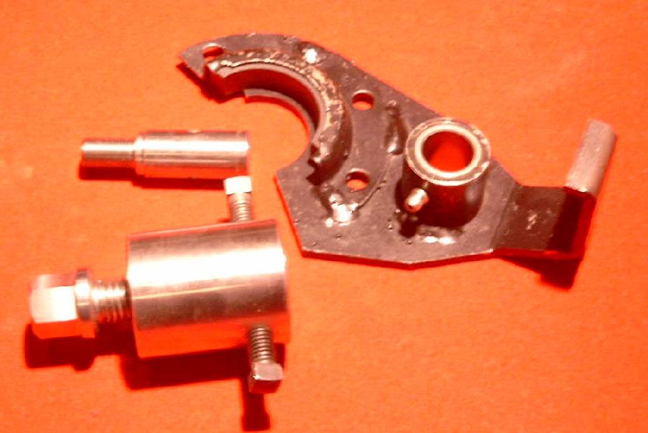

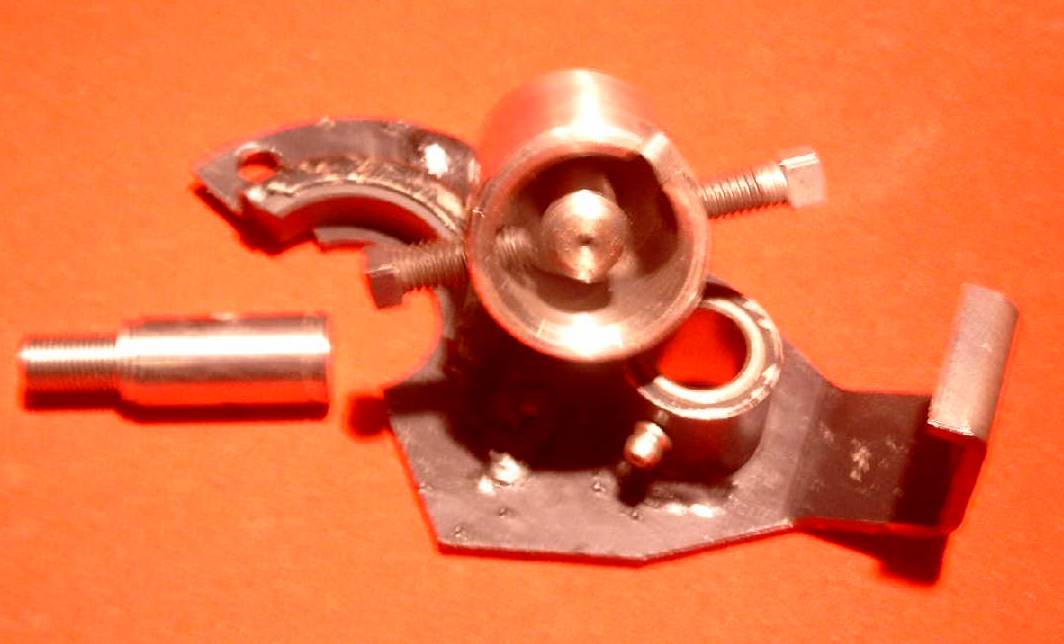

        Honey I'm Home! Front Roller Hanger Removal Tool... [img]/content/btubb/images/%%GRAEMLIN_URL%%/laugh.gif[/img] [img]/content/btubb/images/%%GRAEMLIN_URL%%/wink.gif[/img] :p [img]/content/btubb/images/%%GRAEMLIN_URL%%/cool.gif[/img]
          Re: Honey...I'll be back in an hour....
          Bolt on pivit stud and a Stahl's front roller bracket removal tool , a must for any serious technicians tool box.
          My question is, has anyone ever had a bolt on pivit stud fail, snap off, etc..

            Dear Mr. Felix an dear Mr. Mike; I know these studs are x-isting(?) I even have them, but only having one hour left before the machine(s)were needed again and having a lot of welding mess at the other side of the machine plate(plus not knowing what was wrong-more than I knew at that moment-)made me decide to reweld the broken pivod stud.

              Martin, there is nothing wrong with welding the old on back on. I'm sure it is just temporary anyway and you are going to fix it properly another time.
              Been there, no fun. Just thought since we were talking about metal fatigue and/or failure, I would hit on the rear roller bearing support.
