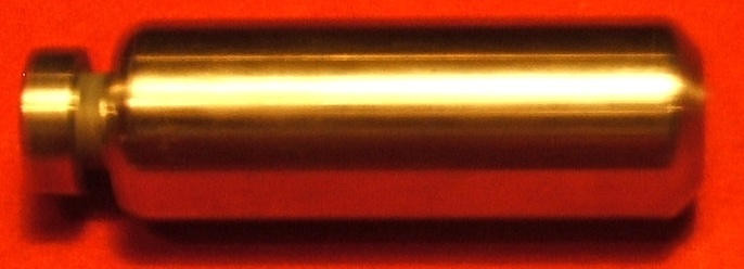

            What is it?
              Re: New Tool
              Looks like some type of insertion or removal tool…Perhaps for roll pins?
              Does the cylinder have a spring?
              Does the shaft have a bearing on the end of it?
              Was this tool designed for pinspotters, or was it designed for something else but works on a pinspotter?
              To get an idea of its size, how about placing an object next to it.
                Re: New Tool
                Yes, it is a homemade insertion tool with no spring or bearing!
                This tool is 3 1/2 inches long and the diameter would be the same as a quarter. [img]/content/btubb/images/%%GRAEMLIN_URL%%/wink.gif[/img]
                  Re: New Tool
                  Rivet installer for kickback panels. :p :p :p

                      Re: New Tool
                      Takes the adventure out of holding the rivet with your thumb and fore-finger. I use a thin piece of flat steel with a hole in it to hold the rivet then go whack!

                        Re: New Tool
                        Pretty cool tool there Felix. Sure beats using a thin piece of hardboard…only to find, if the first whack wasn’t hard enough…you lose the rivet.
                        Nice call Tall Paul.
                        Triac
                          Re: New Tool
                          Nice tool.
                          King method:
                          1. Take rivet and insert in hole.
                          2. Push a small piece of duct tape over the rivet.
                          3. Beat on rivet head.
                          4. If you do not hit it square, the tape holds the rivet to the panel and you do not lose rivets.
