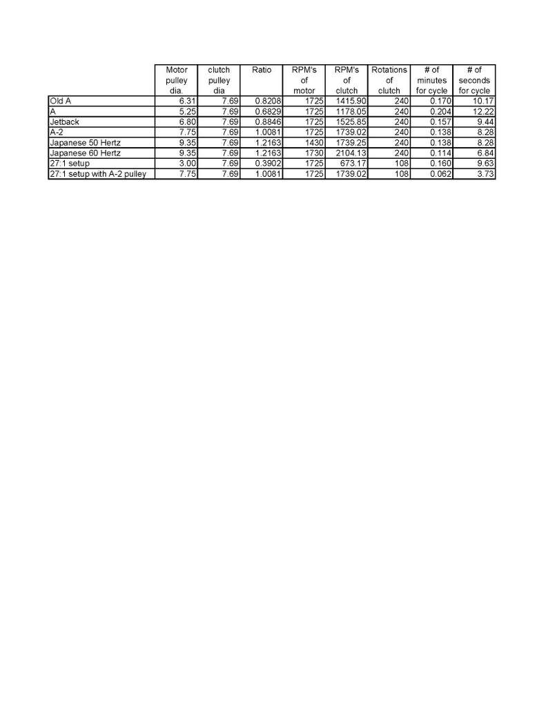

                  The Japanese A-2 pulley was larger as the pinsetters were to be installed onto the 50 HZ grid in Japan. If that pulley was installed onto a 60 HZ grid...the time for a cycle was cut down to 6.84 seconds from the normal A-2 speed of 8.28 seconds for a complete cycle. Timing the machine above...it looks to be right at 8 seconds or so...so I would say that it is a Japanese machine with a Japanese A-2 pulley running on a 50 HZ grid or they have 60 HZ grid and have changed the pulley to the American setup. The time for a cycle would be the same as an American setup on our 60 HZ grid.
                  There are places in Japan now that have 60 HZ versus the old 50 HZ. East Japan has 50 HZ versus West Japan having 60 HZ. With these changes though...it would be possible to find a center with 50 HZ pulleys running on the 60 HZ grid. I have even seen them here in the states...we called the Japanese pulleys pie plates as they were big.
                  Just for fun I added the 27:1 setup and how long it would take to cycle using an American A-2 pulley...by accident of course as none of us would ever try doing that on purpose...
                            First time posting on anything so i don't mean to bring up a old thread or anything but all i know is that I'm really happy i stumbled onto this and that graph you made! I have Jap A2's at my center and they almost look like they're running at this speed and its a little scary to say the least. Ive been looking at different ways to slow my machines down and this just helped out a TON!
