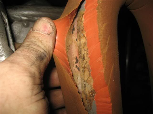

                          As far as anyone using "liquids" to install lift rod covers. It is not the damage to the lift rod cover you should concern yourself with...it is the damage to the lift rods themselves that should worry you.
                          This is the inside of the cover and the lift rod is visible...through the rust of course. These lift rod covers were only on for about 4 years before we trimmed them back and found this.
