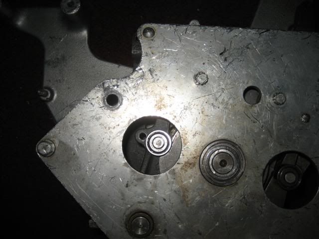

        Cycle machine to 90 degrees second ball. Check to be sure the strike cam follower has fallen into the low of the timing cam in the dtector.
        It should look like this...
        If it did not fall all the way into the low of the cam and there is a gap between the bearing and the cam...you may have a restriction in the movement of the D shaft. This could be caused by the moving deck scissor latch having a bind (as mentioned above by Popey) or there may be an issue with the strike cam follower which has the pin detector link attached to it. The pin detector link runs under the detector to the bottom of the actuator links in the clutch reset linkage. Check for a bind there also.
        If the roller on the strike cam follower looks like it never started into the low of the timing cam, there will be a large gap between it and the timing cam and you did not get a strike detection. Spring being off like Popeye suggested would come to mind first...but answer this question...does the detector detect a strike when the deck lowers during a first ball strike cycle? If so...I would suspect the detector rod adjustment at 0 degrees or the alignment of the roll pins on the detector rod.
