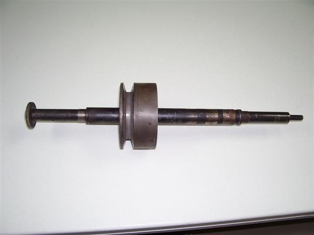

                    I made a "slide hammer" out of an old Jack shaft, and a pinwheel clutch pulley. It works vary well! I think using a long piece of conduit as a punch would work too, until the conduit ends got deformed.
                      Like this?
                      By adding a washer and a nut to the setscrew...be sure the washer is big enough to fit inside the bearing...you can use it to pull the bearing.
                        It's sort of like that. I have one of the jack shaft bearings and spacers bolted on one end to make a "safe" handle, as not to smush fingers. I bolted a thick washer on the opposite side, which gets seated behind the bearing race. a few good whacks and the bearing race pops out.
                          How the heck are you attaching that to a deck shaft bearing?

                            Mike...put a washer that will fit inside what you are trying to remove on the end of the slide hammer. Insert the washer inside the bearing then offset it to catch the race that is stuck in the shaft. Smack it with the hammer...then move the washer to the other side of the bearing and do it again. You can move 90 degrees and give it a smack too...eventually the race will come out...or the washer will break.
