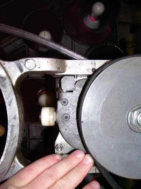

    Need some thoughts or suggestions on this one, I have a lane that fails to index on the 1 or 7 pin wires, pin comes down and trips lever but it just sits there, it does not however happen everytime what could this be

      trip lever adjusted too high? i had this issue not to long ago, it would do it at random positions and times
        --Check you long turret drive belt tension.
        --Check your turret level adjustment.
        If the the latch completely clears the bearing on the stop lever
        Then either your short turret belt is slipping or the lower clutch pulley is slipping.
        If you need to crank up the tension on the LTD belt to make it work then
        it may be time for a clutch rebuild.
        Go with what works and not what the book says.
          Tried some things during league found tightening the ltd belt actually made the 1 or 7 not trigger more often back off he pressure considerably and it's not happenening nearly as often still an issue though

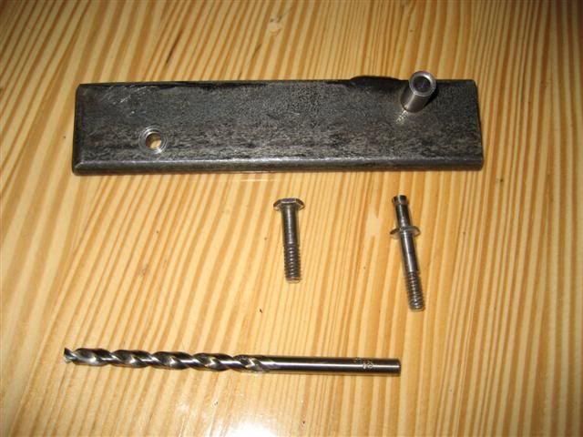

            If backing off the long turret drive belt tension makes it better...then the issue is the indexing latch is not getting off the top of the roller on the stop lever. If you are seeing the lever move from the pin landing on it and you are seeing this issue...no doubt there is some wear at the pivot points of the indexing linkage. If you do not have the bolts installed in the ends of the short indexing link...I would recommend them. These will remove quite a bit of the "slop" that occurs at these points...even wwhen the parts are new there is some "slop" as the x-washer pins do not clamp down. The bolts remove this movement and allow the linkage to do its job better. They are sold by Quality...12-1587 and 12-1588. Also...if you do not have a positive stop for the indexing latch...this would be a great improvement to the machine and will allow you to eliminate the stop plate adjustment at the back of the indexing trip lever.
