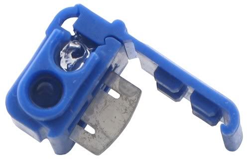

Common issue with this kind of problem is the connector that is used to tie the scoring system into the managers control circuit. They are usually Scotch-Lok connectors.
They tend to come loose due to the wire size that is used to tie the pinsetter to the F box or 6 Box. This causes the wire to loose its connection and the pinsetter will turn off. When you turn the machine on by the switch in the back, this bypasses the scoring circuit.TSM & TSM Training Development
