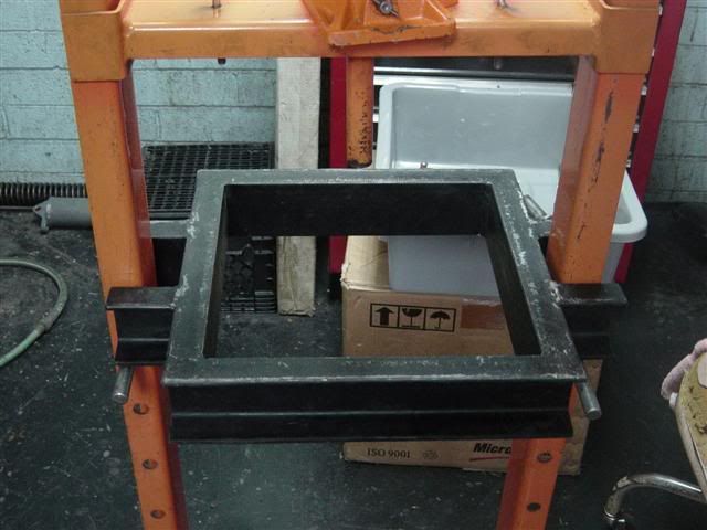

        As for the press a 20 ton will do. I have been looking on here but cant find it but Steve Stafford had pics of a table he made that goes on a 20 ton press that works great for doing gearbox assemblies. A standard press table will give you some problems because the standard table doesnt have the inside clearance for the big stuff. I had one made like Steves, and a few other have also.
        Hopefully he sees this and can point you to the pictures of it.

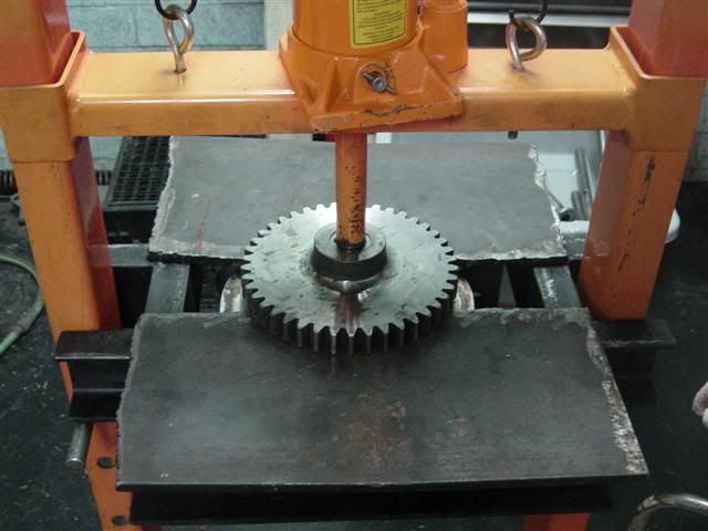

            Here are a few pics of the setup I had for a 12 ton. The same idea applies to the 20 ton setup I have...the I beams are just a bit larger.
